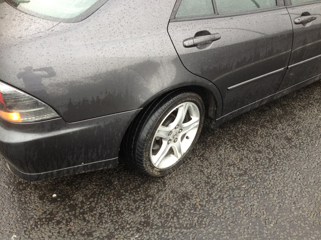

Yesterday afternoon I pulled out of a wet round about a little quick but not much quicker than usual. I lost the back end of the car and it span 180°. Though a bit shaken no one was hurt but the car had hit the kerb and the rear drivers side wheel is now at an angle.
I had to get the car recovered which was a bit of a task as the car always wanted to steer from the back. Any ways I've still not heard what the exact damage is or how much its going to cost. I looked behind the wheel it didn't look like anything had snapped off but that's as far as my observations could tell me.
I know without seeing for your self its hard to tell, but has any one had any experience of what parts are likely to be damaged and the likely cost. I'm sure I'll find out from the garage this afternoon but yeah gutted!
There's a rear track control arm that is used to adjust the rear toe. Looking at your photo this has got to be bent, it may have damaged the top bottom wishbones as the wheel angle now is well beyond the scope of adjustment. Worst case scenario the subframe has been damaged.

Due to the way the wheel is bent I would have to say all the arms holding the wheel hub are bent if your lucky if not then the sub frame is as well.

Any way since my last post the garaged has requested a diagram of the rear suspension from Lexus Poole. They kindly sent one across but it took yet another day for the garage to act upon it. In the mean time I personaly spoke to the parts guy at Lexus Poole who was very helpful and was able to put up with me phoning up every day to make sure the garage had been doing what they had said.
It was the easter Saturday that I finally got a price. As the parts man at Lexus told me to expect, the hub along with a new bearing needs replacing, along with 4 other parts like the wishbone arms and so on. Total price for the repair is about £1500. I know from speaking to Lexus the bulk of that price is actually the cost of the parts. I'll need to use the spare wheel for now as the existing one is no good. Probably get one from eBay.
