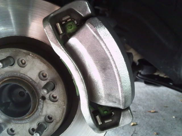

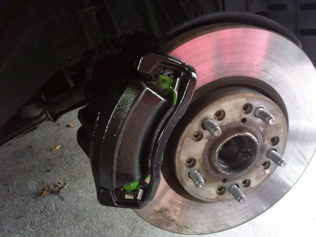

I also done mine in black a few months ago.
I brush-painted them with a couple of coats of Halfords' own make high-temp enamel followed by 2 or 3 generous coats of Hammerite. I didn't bother with any lacquer as the decal supplier mentioned that it wouldn't be necessary.

I took to mine with a wire brush attached to a drill then put a coat of clear over the black. Been on there nearly 2 years now.
