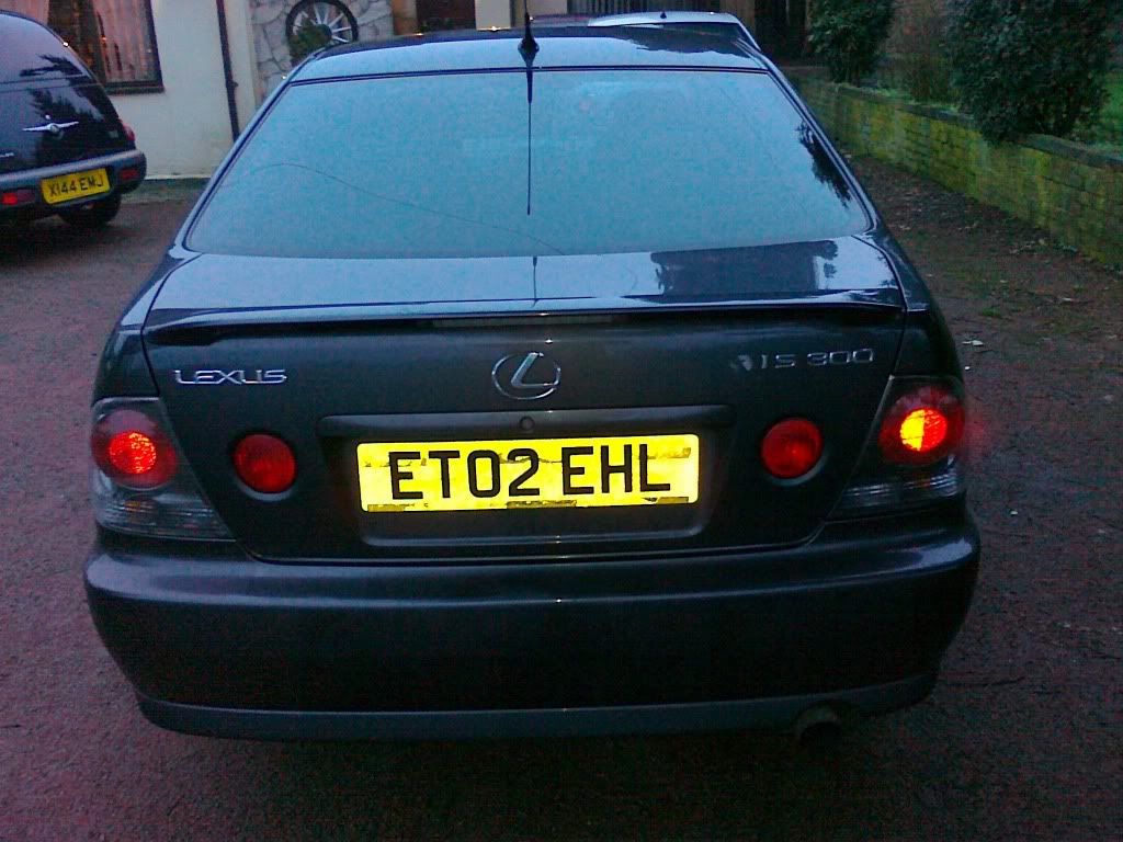

Well I fitted my sport boot spoiler at the week end and I thought I'd just share the experience with you, and some pics.
It's taken a while as I needed to get the spoiler sprayed to match the car. I also had my sport grill sprayed at the same time as this was off my previous Lex in granite sky.
First of all I made a template out of wallpaper from the old boot lid that the spoiler came attached to see previous post here
Then came the moment I was dreading. Good job I got this for my birthday last week.
Then after a little bit of drilling and filing to tidy up I had this.
and this.
I only drilled 3 holes, the two smaller ones for the bolts and one bigger one for the cable.
Rather than use the plastic clips from the original and have to drill another 4 holes I just used double sided trim tape.
and finally it was looking like this.
Luckily there is already a connector inside the boot lid for the new brake light.
The only thing now I had four brake lights which I don't think looks too good.
So I took the bulb and holder out of the one on the parcel shelf and just tucked it under the trim so it doesn't show. You can't just disconnect it or remove the bulb as this brings on the bulb failure light on the dash.
That's better.
And heres a few pics of the car after washing and polishing.
Sorry about the long post but, like most Lexus owners, I'm just so pleased with my pride and joy.
Dave

First of all, what year is you Lexus?
If I understand you right you had the standard sport rear spoiler without the brake light as fitted to the early sport but after an accident you now have the later rear spoiler with the LED brake light.
Do you still have the rear brake light on the parcel shelf? has this been disconnected or bulb removed?
If this is the case then it will bring up the warning light on the dash to show that you have a bulb failed. Now on mine if I remove the bulb from the high level brake light it brings up the same light on the dash as a rear light bulb (a picture of a car in plan view with beams of light coming from the rear corners). Now I'm not sure but I think on the earlier IS200s if the high level brake light fails it brings on the warning light that you have described, the same as the hand brake.
What you need to do is check whether the old brake light, the one on the parcel shelve, has been disconnected or the bulb removed. If this is the case then all you need to do is either reconnect it or replace the bulb. You will need to remove the whole brake light housing from the parcel shelf to gain access to the bulb and holder.
If this solves your problem then I would suggest you then do what I did with mine and just take out the bulb holder complete with bulb and hide it under the parcel shelf covering.
thanks Dave,
its just a 2001, and yeah it originally had just the lip spoiler with no brake light in, but after several arguments they agreed to replace it with a new spoiler - originally they didn't even replace the boot, even though it didn't shut properly - but they just changed the badges to make it look like it had been changed, moral of the story should have gone to Lexus Coventry. :tsktsk:
yeah the brake light unit is still on the rear parcel shelf, but i'll have a look to see if they disconnected it or removed the bulb, knowing them they've properly just taken a hammer to it until it stops working.
Seen as im off work for the next couple of days think i will take a look at it : )
