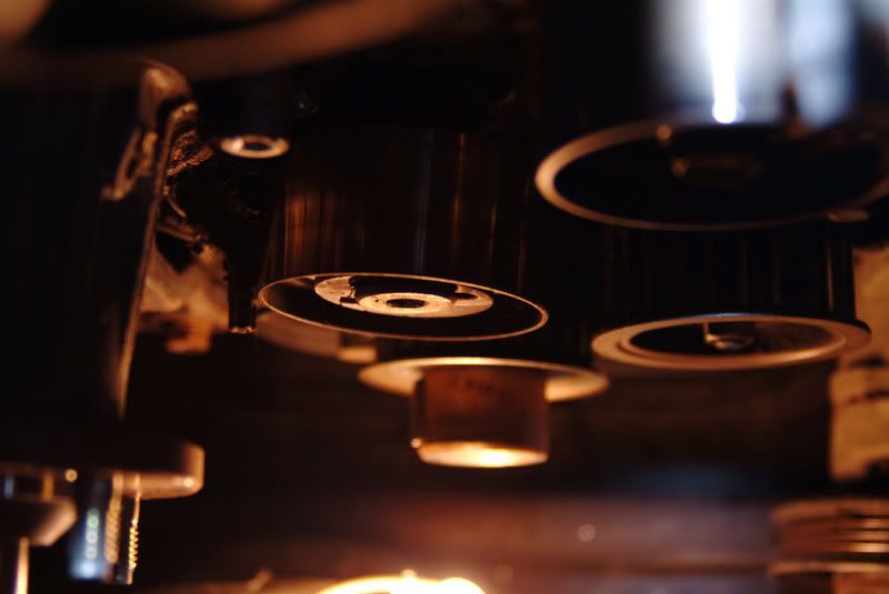

You can see in the next pic how the tensioner pulley on the left is out of alignmentcompered to the others,

The problem it seems wasn't the belt at all, Half the belt was still doing the work fine, but the tensioner must have been worn for ages, so even if your belt looks good, you could still be in for a supprise!

this is why the belts must be checked every 10k after the 60k service. the tensioner pulley wears and as you can see pushes the belt onto the cover, wearing it down to nothing. ive never come across one thats snapped yet but i have found them as small as 9-10mm!!!! so do please check your belts its easy to do.
