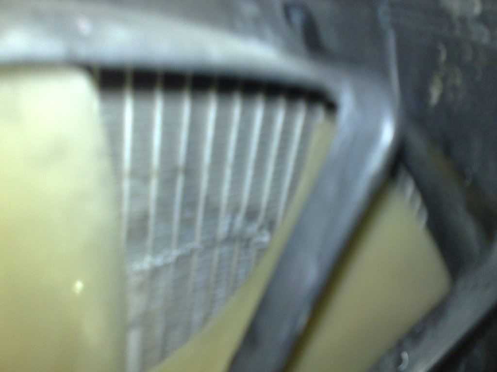

Well found the whole and it have been told it can be fixed with some kind of liquid metal? This would be a temporary solution, as a Radiator is needed. But i dont think i'll bother. I'll just wait and buy the Rad.
I dont see how it can have burst a whole thou. Looks almost like it's been hit, but front inside!

Got a photo (it's not great) by slipping my phone behind the fan, but it did not auto focus correctly.
