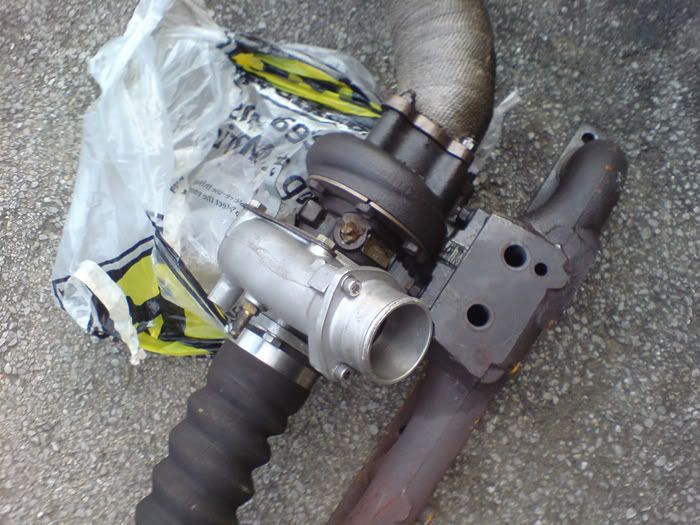

Well after owning a Astra GSI for a while i got back into driving the lexus once again and really missed the torque of the turbo....luckily enough Adie was selling a turbo kit on here!, i managed too bite his arm off to get my hands on it. I havent rushed into fitting it as i have been collecting bits and bobs for it. Here is a picture of the turbo/manifold.

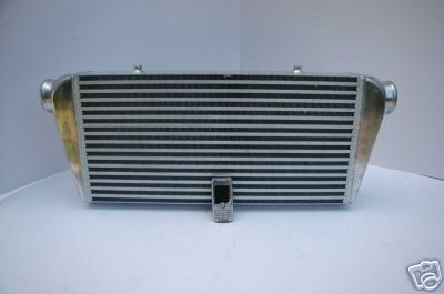

There was a few extras i needed to buy to make a complete kit, i have sourced piping for the kit and a bit extra hard piping too change the turbo to airfilter. One other goodie was a return oil line. Once i had these i started looking for a intercooler, i went with this one which is very large(780x300x76) but should with a bit of trimming make it under the bumper... :whistling:

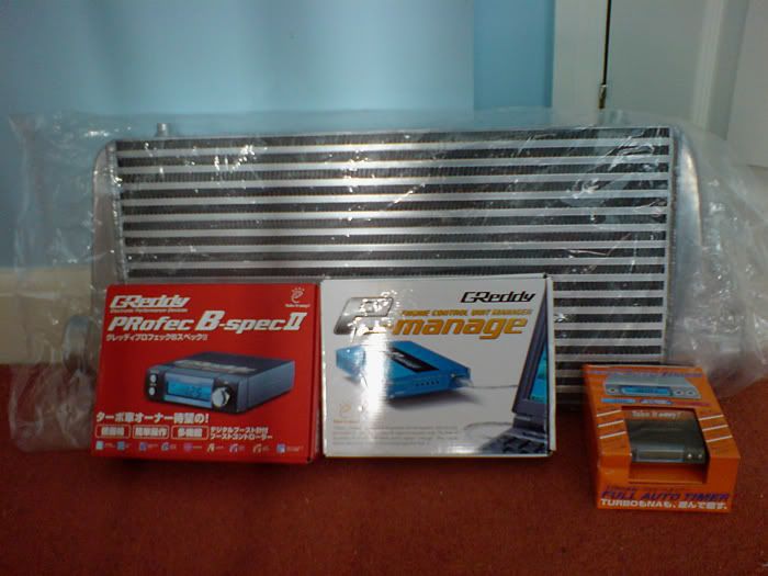

Next i looked into a aftermarket ECU and after talking with adie decided to go with the greddy emanage system, Got it quite cheap on eBay but was stung with a hidden import tax charge.... :crybaby: but moving on i decided to get a boost controller so i can switch between sensible and fun :shifty: along with a turbo timer as that was my problem with the GSI... driving too work i sometimes rushed it and turned it off hot... naughty boy but i paid for it in the end.... with the lexus i plan on having this turbo timer fitted too save the life of my turbo lol.
They all arrived very quickly, i went for the greddy PRofec B-Spec II boost controller and greddy full auto turbo timer.

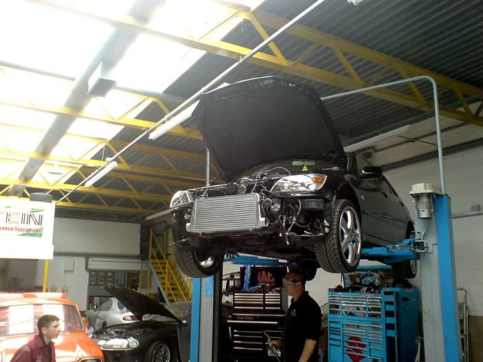

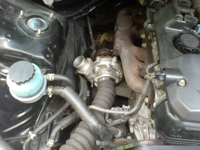

Time for a update!, the intercooler is in position with the bottom mounts fabricated in place, the top mounts are on the way along with a few more bits of pipework. The intercooler too alot of work to fit, horns,aircon pipe and a few other bits had to be modified.The turbo is in place, it didnt need any modification to fit unlike what ive been told about the kit. they started the oil feed as i left today... anyway here are some piccies!!.

That front mount is sooooo big, pretty sure that its a fair bit bigger than mine and TDi had to cut away a big chunk of the bumper to make mine fit, think you may just have a number plate left at the end :lol:

doubt it will be ready in time ellz, which is a shame so will probley have to wait till JAE 08' lol!. we had to do some serious bumer mods to make it fit... some how it fits. i bet it was great driving your car i really cant wait till i get mine back!.
Looks good, i can't help but think your FMIC is bit OTT, its bloody huge. more than half of it will be restricted by your bumper.. Maybe you bitten off more than you can chew with that one :hehe: any pics with the bumper installed?
