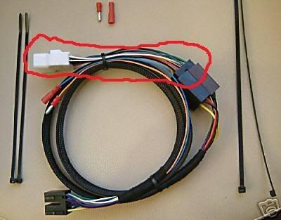

Can someone get a front on pic of the white connector? The part of the cable ive drawn round looks like a standard ISO connector that would be available in a place like Halfords.
Looks like this guys basically just got a lead that will fit onto the wire going too the speakers as pictured below:...
...and then just extended it, adding a couple of wires and doing a neat job of it and then selling it for £60!
I looked in halfors today for the part ive circled but couldnt find any.
you wont find the white connector in Halfords or any other liek place. its unique to toyota. certainly the connector for my nav bypass unit was unique and i had to buy a minimum of 100 pieces.

Can someone get a front on pic of the white connector? The part of the cable ive drawn round looks like a standard ISO connector that would be available in a place like halfords.
would you not find that type of connector in RS electrical, Farnell or Maplins catalog

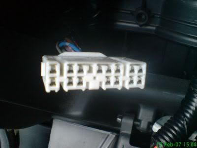

Been reading this thread with some interest after working on a IS200 today and bypassing the Amp to fit a nice new Stereo
Bit shocked at the £54.95 price the guy on eBay is charging for the bypass lead, we made up an almost identical item as a one off and if there is still enough interest in these would be able to make up some more without too much difficulty. Even in small numbers we should be able to knock them out for under £40, obviously if we could get enough orders this could be reduced further!

Hi
To check if you need this lead then have a look behind your glovebox (this can be dropped down by popping out the 2 hinge pins under the front of it) and see if the amplifier is there, it will look like the one in photo below!
Hope this helps,
J.

@CCA
I also made my own, but i had too put the wires directly into that plug.
(Plug shown below is the one that comes out of the amp and goes too the speakers etc, and i put the wires into those slots)
Idealy what i want is a male end of that plug so i can crimp the wires into that then connect that onto the plug that goes too the speakers.
How did you overcome this problem?
As you can see below i have circled the part i need. Not being funny too Fargo or anyone else, but this really does look like a connector you would buy at Halfords etc (not that i have been able too find it at Halfords).
It looks too me like the guy had found a source of these ISO leads then just made an extension piece, which is like you said CCA 'cant see the point in having the extra connection so near the amplifier plug', why didnt he make it a one piece lead
Good luck with the search Vinokirk. If you do find any out there lets us know. You try a scrap yard, remove the amp and take it apart, unsolder the adapter and add your own wires.
I believe the Lexus part number for the connector on the loom is 90980-10848.

<_< The part I have circled does look a lot like a lead you would get from a car parts store imho
So does the one that the OEM radio connects to but its not. Its a special order and bulb buy only. As Fargo had to have a few made up.
Well we got the car in a couple of weeks ago and had a look at the system, found the amplifier etc. and as you guys have found a suitable lead doesnt seem to be available for the amped lexus system. Our customer wanted a DVD touch screen etc. but wanted to be able to return the car to standard if he sells it in future so didn't want us to chop the loom.
We had to get the lead made up through a supplier of ours. Only after doing the job did we have a look here on the owners club just to see if this is a common thing and spotted this thread.
£54.95 is a bit steep for this type of lead, for that money we could easily throw in the fascia adaptor!!
We are going to get a few more made up and be selling the lead on eBay in the next week or so for around the £40 mark if anyone is interested.
