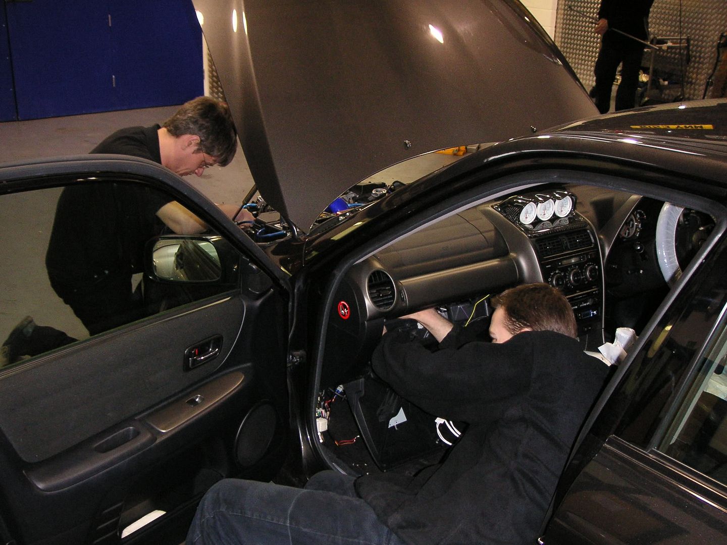

I'm currently having some more work done to my IS by TDI. They are fitting the larger injectors so my fuelling is sorted and doesn't lean off. Also the car will be able to hold the boost as the fuel before was leaning right off at 5000rpm. So it should be mapped to .7 bar as hopefully this will be a safe boost to run on the standard internals.
Also i'm having the camcon fitted (to do what ever it does) :blush:
Also an O2 sim to fool the engine into thinking there is a cat present so no engine management light comes on. (I think)
I've also finally got the gauge pod fitted which I think looks pretty cool B)
I'll update the thread if I think of anything else :yawn:

Check out the gauge pod B)

Also being fitted:
HKS F CON V PRO + harness
HKS Navigator
HKS MAP Sensor + Harness

Few more piccies :D
Modified oil cooler adapter for oil temp gauge
Being fitted
Gauge pod and gauges
