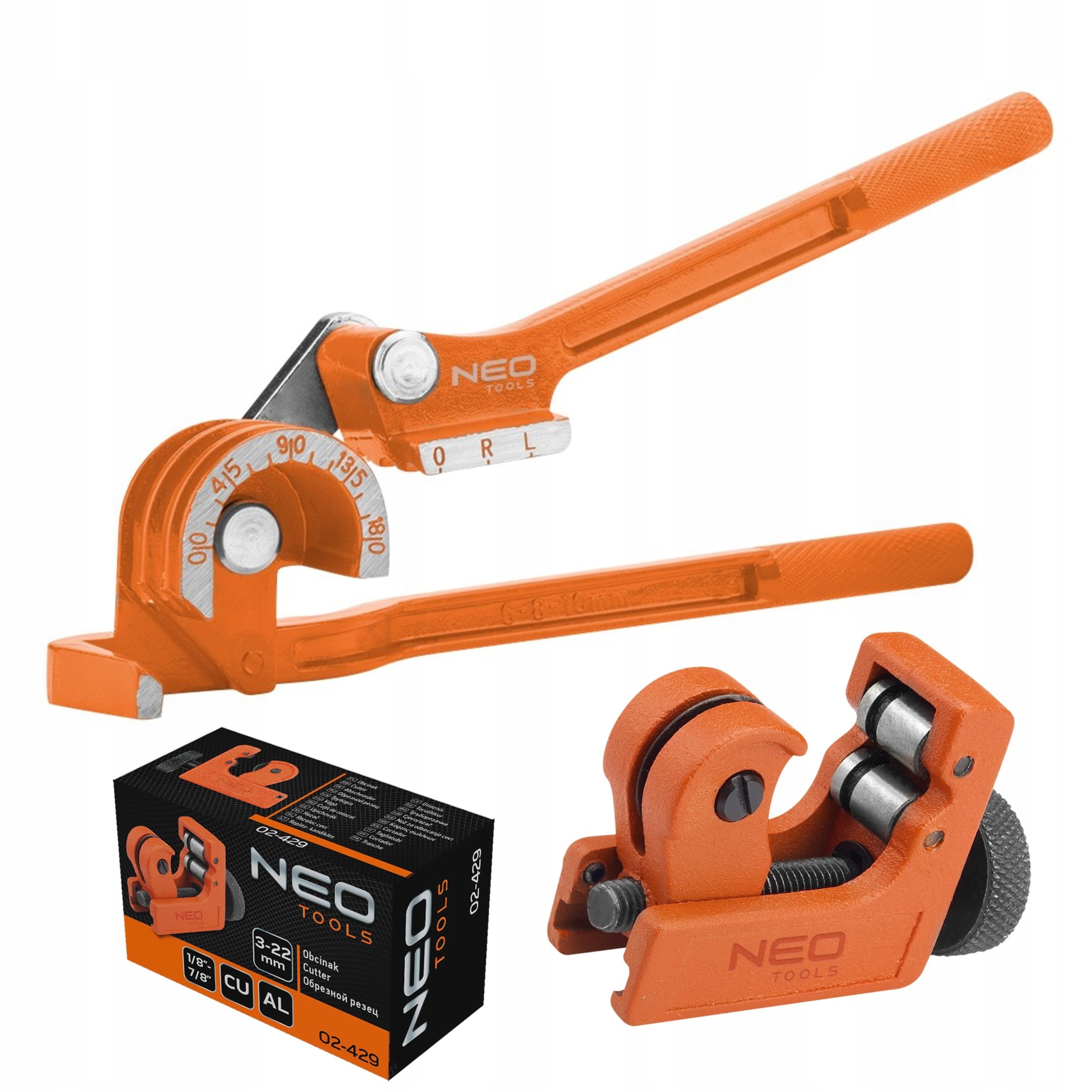

NEO OBCINAK + GIĘTARKA RUREK PRZEWODÓW HAMULCOWYCH
50PLN = 12 USD

It's easy as hell o course if your faulty one is the smaller one(aluminium, not with rubber) . Simply you cut off the original pipe before and behind the tank. There is completely enough space to do it. cut it off, fit new pipe, use leaklock, use metal connection and voila.

So I bought 8mm pipe, pipe bender has range 6-8-10mm, pipe cutter range 3-22mm and connector was strictly on 8mm diameter and it's lenght was 36mm but it's doesnt matter how long it is, because you insert aluminium pipe as long and you want to.
