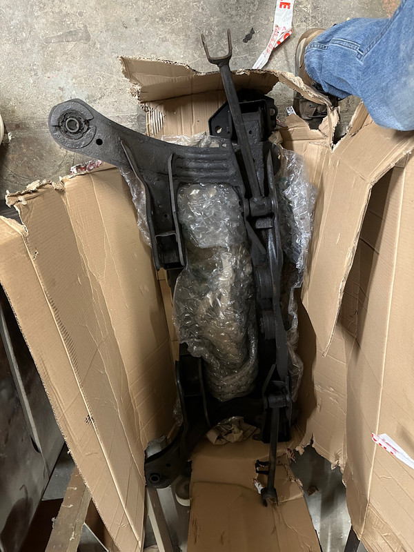

Got my replacement subframe. No rust at all, been properly degreased. Needs new bushes.
From Nissan Auto Spares. £360 including P&P
url
Good to hear, if you’re changing all the bushings you could even have it blasted and power coated first.
Did you get your dog to open the box or was it more of a kid with a Christmas present moment for you 😀
Thought about the powder coating but cost around £150 more so instead will wax oil (or something) it.
Packaging was effective but a bit of a dog's dinner. Having said that it wasn't my dog that opened it
[url=https://postimg.cc/670mrtQZ][img]https://i.postimg.cc/pTbMtdbs/IMG-6864.jpg[/img][/url]
Bit of a slash with a Stanley as I needed to get a photo, send it to the garage and get back sharpish to a desk I was French polishing.
