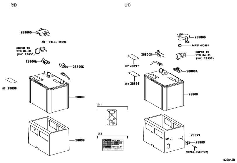

Ive been told that there’s a Battery cover missing on my Lexus is 250c ?
I wasn’t even aware, apparently there’s a thermometer in it too.
is this true ?
Any help please ??
I’ve checked the diagram ?
is this actually needed and every car installed with it ??

Hi my car does not have a Battery cover as such ,it has an open frame all round which is held by the clamps in your drawing .The inner facing side of the case has a wired sender attached to the side which I believe is to monitor the Battery if overheating occurs ,this can be awkward when replacing the Battery so perhaps it has been left off when this was done.If your Battery is not a Panasonic it has probably been replaced .The terminals have their own cover

Thanks for the break down. Yes it must of been left off as it’s a Bosch Battery. If not essential I won’t trail te net for a replacement.
Mine is missing as well. As other mentioned it makes Battery replacement really awkward, so some people may choose to throw it away. Other reason - Lexus uses uncommon size Battery, so some people just go with what I believe is 063 size which fits without cover, is cheaper, usually higher capacity and more commonly available (I believe halfrauds as well advises that).
To be honest it doesn't add much apart of holding temperature sensor, but that said it could lead to unexpected issues - if you leave temp sensor dangling it may fall close to catalytic converter and report that your Battery is on fire. Basically as long as you find the way to secure temp sensor it should be alright without cover.

The heat sensor is located on the left hand side, as you look at it, of the casing. I've never seen a cover on the battery on any is250.

Lexus refer to the plastic Battery enclosure as an "Insulator".
Part number is:  28899-31020
The part number 74433D in John's diagram sits in the Battery tray underneath the Battery and not on top of the Battery as you might expect from looking at the diagram.
I believe all IS250 models would have been fitted with the enclosure as standard from the factory.

The enclosure is not a cover but simply fits around the sides of the Battery.
It is very evident if you look at John Henderson's post above and is indeed fitted to most, if not all, of the photos you have posted.
From memory John the plug is on the left side (positive +ve Battery terminal side). Its on the outside of the casing so it's easier to have the Battery out so that the casing can be manipulated and the plug made easy to access.
