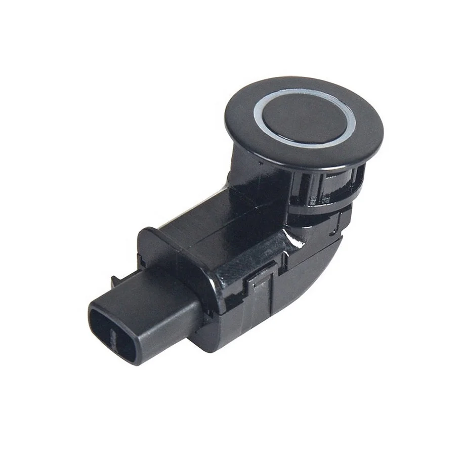

This is the 89341-50011

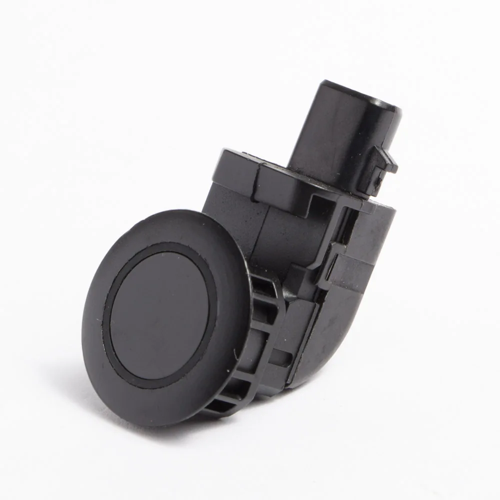

This is the 89341-50050
