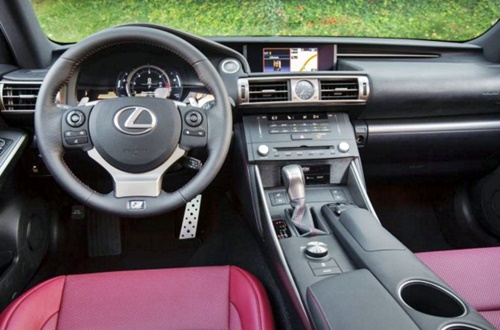

5 hours ago, Brechin Slate said:
Are we saying that this will not be an issue on post 2014 cars then?  We can do a battery change without fear of going through all this?  It'd be good to know!
Apparently not. It seems to only affect cars which have the radio and climate control buttons in this finish:
There are no reports of this problem affecting later vehicles with the below finish:
Now whether thats due to the vehicles being newer and not needed a Battery change yet, who knows?
