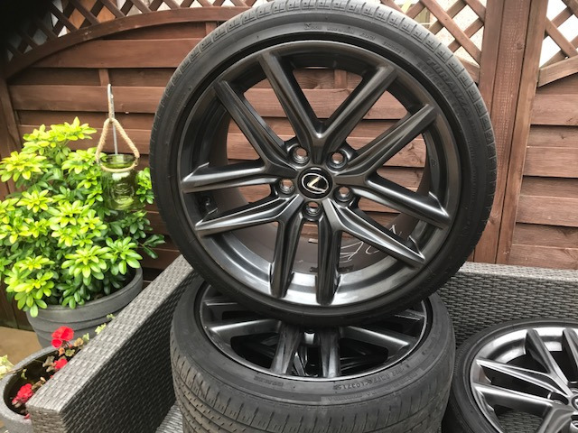

Genuine 4x 18" Lexus Baransu (G Spider) Alloy Wheels with Tyres
These are on gumtree york in Accessories, 7 pictures look pretty decent.
"LFA inspired"... Yes I meant 17" (pic 7-8), but 18" are probably even more similar - I had both on my car. They do not have a name, but are often sold as "F-sport" wheels. And yes they are staggered 8J/8.5J and probably cast.

I have seen quite a few recently, usually comes ~£750-1000. Sometimes with tyres, sometimes without. I got mine for £550, but they had bit of kerb damage and set of crap tyres (3xDunlop Sportmaxx 001 and 1 ContiSport 5). Since then I had them refurbished and fitted Michelin PS4's so I reckon doubled the value. You can still buy them at the dealership ~ £550 each, probably that is why they are still expensive - "current model wheels", hence you pay premium. Generally, all other 18" for Lexus Mk2 ~ £450 for set.

Not posted for a while as nothings gone wrong with it !!!  but this is my car and what it looks like with the G Spider wheels on....
