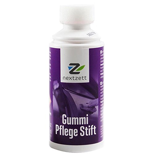

I use Gummi-Pflege on the door and boot rubbers, excellent stuff. I'd avoid using silicone as it can attract grit and dirt and it's a bugger to remove should some get somewhere it shouldn't..
Solved freezing issues and squeaky seals on my CT 200h.
This is the stuff: https://www.amazon.co.uk/dp/B002MZZNU8/ref=pe_3187911_185740111_TE_item
I've got the Einszett version in the garage so I'll dig it out - sounds like it's still the best type of product to use after all these years thank-you both 👍
I use Autoglym Rubber care on all door seals. Top stuff easy to apply. My guess is the door seals on these cars will be mega bucks so well worth preserving, not bad for the boot seal for replacement as it is not so complicated and shaped as per door seals.

Do you know if the Autoglym rubber care stuff is a similar product?
