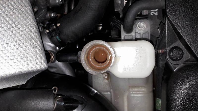

I got my car back on Friday, February 9, I traveled 50 km to go home and everything was ok. The next afternoon, I drove 20 km and back in my garage I see a big leak of coolant and a big puddle under the car! The big problem is that the liquid is a little greasy and mixed with oil.
With a friend we found the origin of the leak: When I start the car, after 3 seconds, the big engine coolant supply hose becomes hard and the coolant leaks through the hose too much full right next to the coolant reservoir cap.
The coolant in the tank has a milk chocolate color.

I can only think the coolant is contaminated with engine oil or transmission fluid. I would check the levels of both engine and transmission.
I suspect the radiator/pipe work had a knock during the work done by your mechanic and it has damaged the transmission oil cooler inside the radiator and it is leaking transmission fluid into the coolant.
It is very important that you don't draw coolant into the transmission so I wouldn't use the vehicle again, or possible disconnect the transmission pipes going to/from the radiator and join them together - bypassing the cooler in the radiator.

Bad news : The LEXUS workshop manager just called me, the coolant is contaminated with transmission fluid (radiator dead). He called a gearbox specialist who told him that the gearbox was probably dead because the coolant is attacking the clutch discs.
The workshop manager advises me initially to replace the radiator and to drain twice the transmission, but without guarantie of success.
