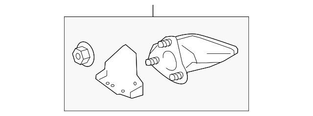

I have attached the photos now with the piece that was missing installed. The correct reference is 52161-53070

Sorry, i may not explain very good because of my English, i have attached a photo that might help you understand what i want to say. The end tip is mounted to the exhaust it comes with a piece that they somehow connect to the exhaust, but i am not very sure how they did it, as i left the car and they gave me it already mounted.
Let me know if you have more doubts, i will try to help :)

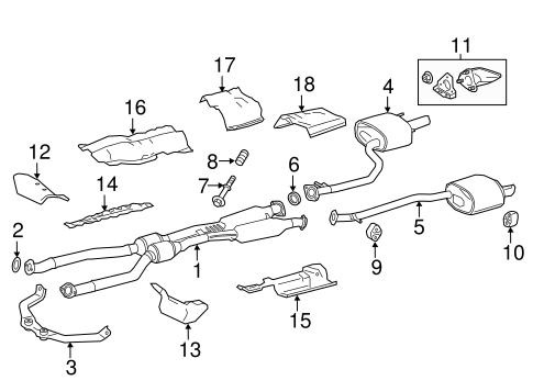

Been checking this based on the item number 17408-31110 (Tail end pipe).
Seems it is mounted on the muffler only.
Yes correct, those parts come included on the muffler tail, you dont need much more than that.
