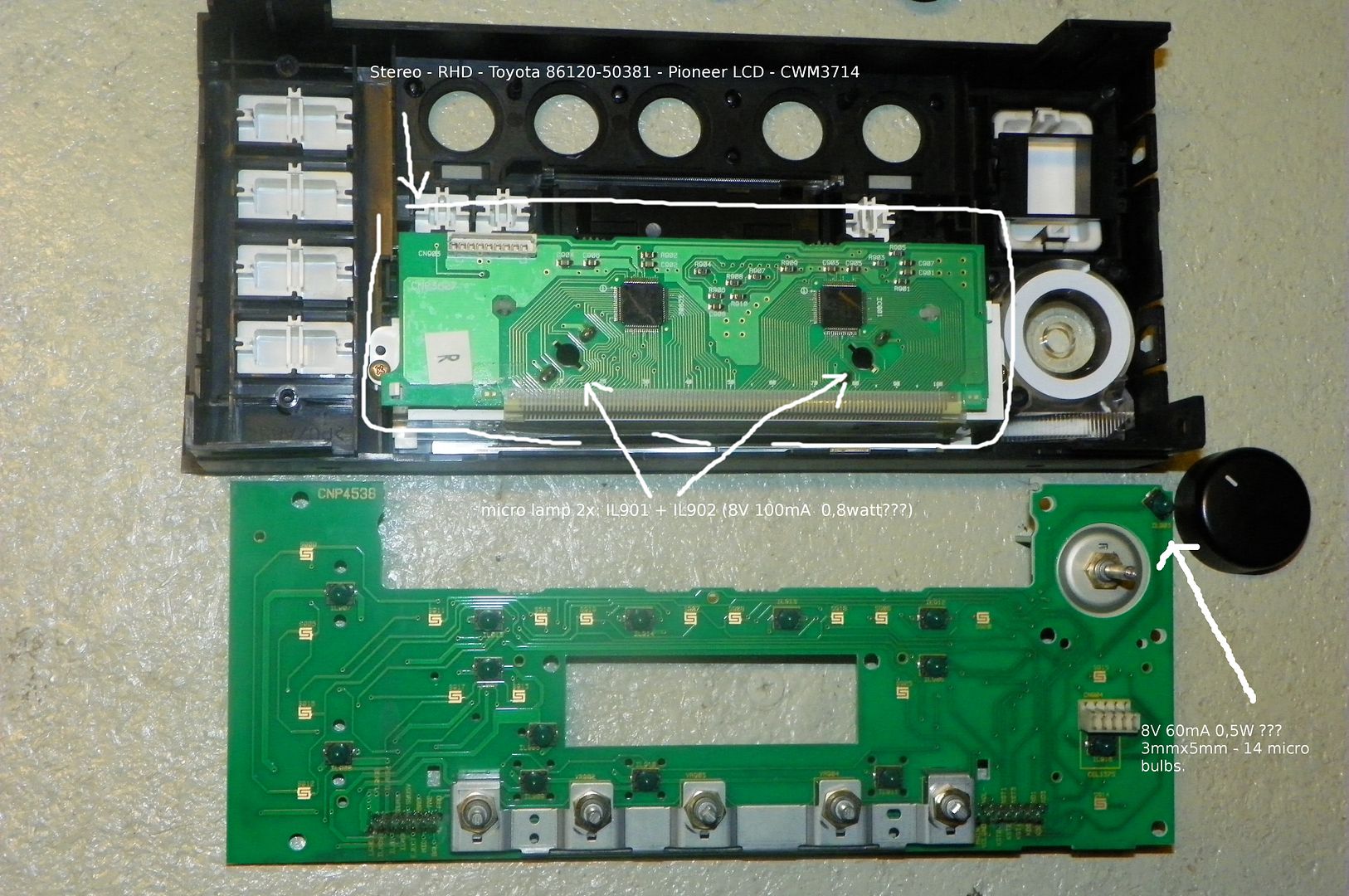

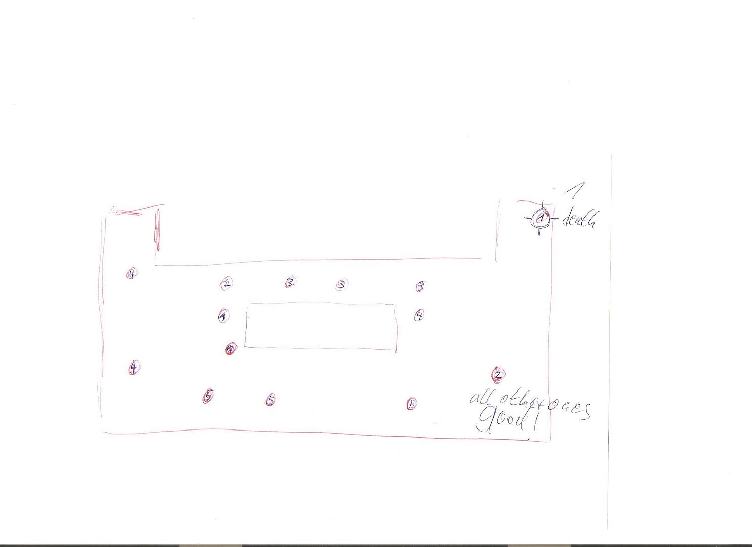

There are 14 soldered on bulbs for the buttons. 4x3 bulbs and 1x2 bulbs are parallel-connected.
In my case it was the one bulb for the on/off knob.
stereo%20-%20key%20board%20-%208V%20006A
PS: Does the bulb from that on/off knob still work on your stereo.......?
This is unlikely to be the bulbs. There are 2 Large Transistor Voltage Regulators in the corner of the board. It is highly likely that the Emitter Resistors (1 ohm) have fried on the board causing the print to go open circuit. This is caused by the current demanded by all those bulbs being high ( a few amps ). The cure is to repair the printed circuit board, and then replace all the bulbs with LEDs. You need to fit limiting resistors as well (LEDs don't like 12 volts) which involves cutting the print. The LEDs draw much less current, and so the regulators run much cooler. My LS400 had this problem when I bought it in 2006, so I carried out this modification and the lights still work perfectly.

On/off knob lights up again. I changed the soldered in micro bulb. 8V / 0,06A / 0,5watt / bulb head is about 3mm x 5mm
Cheap ones from Fleabay work just fine: 5 - 12 V  / 0,1 A /  3mm x 7mm
