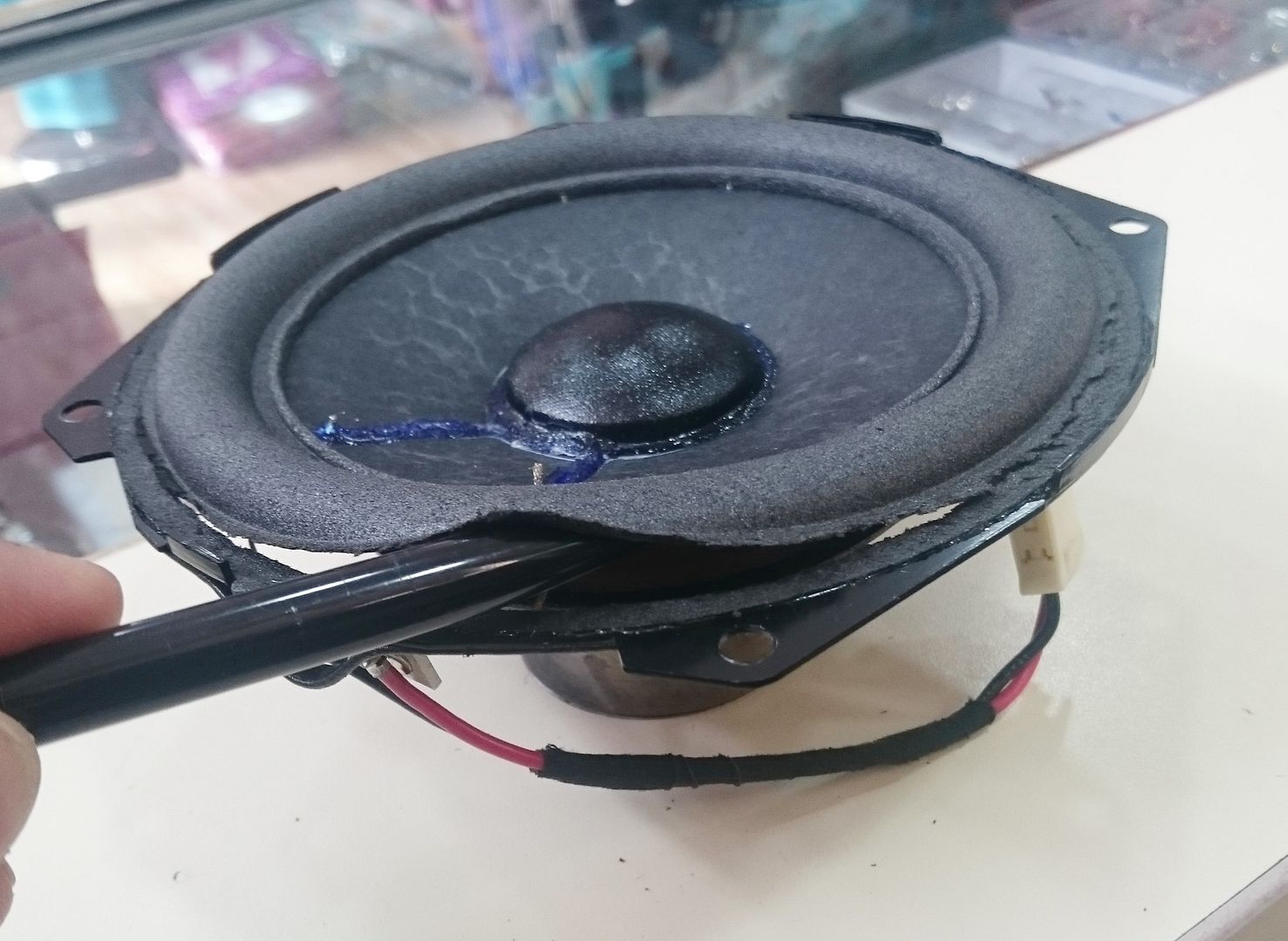

The passenger door speaker was blowing in my facelift 430 so I decided to fix it.
Here is the procedure for removal of door card.

The speaker is held by 3 screws and one connection - undo these and its comes straight out.
the problem on the speaker is very clear - the cone surround has become detached and will need replacing ( replacements on their way)
There is a video on You tube which shows how to repair the speaker surround
hope this is useful to someone - cost of 2 speaker surrounds is about £12.

Yes it will, or simply use silicone as others have done and you won't even have to take the speakers out, just the door card which is easy.
A common  experience in hi-fi. Speaker cone outer edges are suspended with-usually - rubber foam, which decays over time (and all that vibration?).
The support is really just to hold the cone centrally and stop it vibrating erratically.

Took the card off.... the speaker cone rubber was COMPLETELY detached all the way around... - i've glued it for what it was worth... - we'll see if it makes any difference, - if not, I might consider upgrading the speakers...

Thanks everyone.  The fix has worked... sounds much better, although I did it with some rubber glue and the brush which comes with it... think I could've done a much better job with silicone and a sausage gun... - so if the problem comes back I'll do that, - if it comes back again, I'll consider buying new foam rings :)
