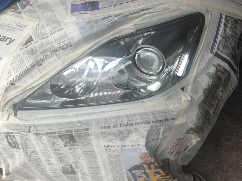

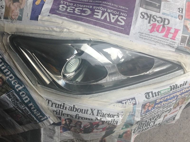

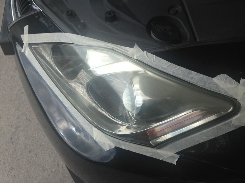

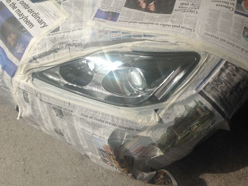

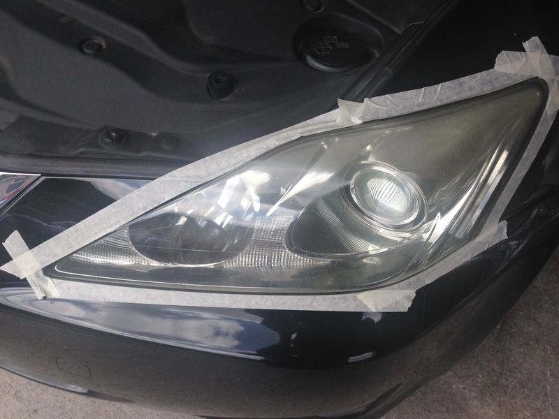

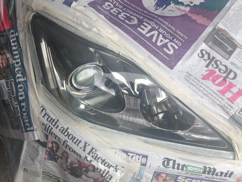

Finally got around to pics.Taken with a camera phone and dont show up nothing like how yellow and worn they looked.They really were very faded and yellow on the top half.They look as new now.
Before
After
Before
After
